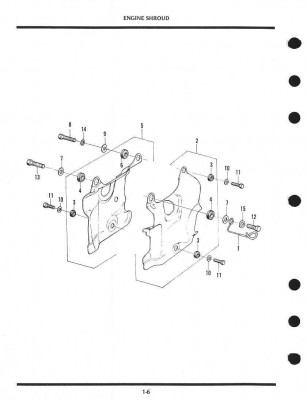

So does anyone have a theory about WHY the shroud bolts are so prone to breaking AND a method for making it less likely to happen?  (just got through fixing 2 broken shroud bolts)
Here are my guesses as to possible causes and solutions:
a)  bolt overtightened          solution:  torque properly
b)  bolt too loose                solution:  torque properly
c)  factory bolts too hard/brittle
                         solution:  replace factory bolts with softer bolts more prone to bend rather than break.
Does anyone know what the real cause is?
Is there another cause I haven't considered?

You guys talking about Side Shrouds? Never seen one break.

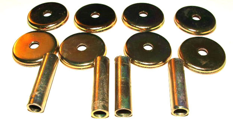

Fan Shrouds? Constant force on 6mm bolts that should have been 8's and most people have never
seen the inner washers that go under the bushings so the steel bushing doesn't dig into the head &
cylinder material. The inner washers are a different shape and fall off when installing the fan assy
but I add a dab of silicone seal and they stay in place. Photo shows 8 of same washer.

Sorry, yes.  My question was about the fan shroud bolts, not the side shrouds.
And I was mainly wondering what steps the seasoned Honda 600 veterans take (if anything) to keep the bolts from breaking again in the future.

If you look at the attached scan of a parts manual note that each rubber cushion has a metal sleeve in it's center which rests against the cam box and because this is of an earlier version there is no bolt at the bottom.  But the connecting bolt includes the washer rubber cushion with the sleeve making it able to achieve the torque needed to hold every thing in place.  The other page shows the same cushion-washer-bolt configuration and the sleeve is still needed just not shown.  The sleeve allows the required torque and by adding a drop of loctite on the threads will ensure the bolt stays in place.

Fan shroud mounts can be purchased here:
http://www.honda600carparts.com/engine.html
