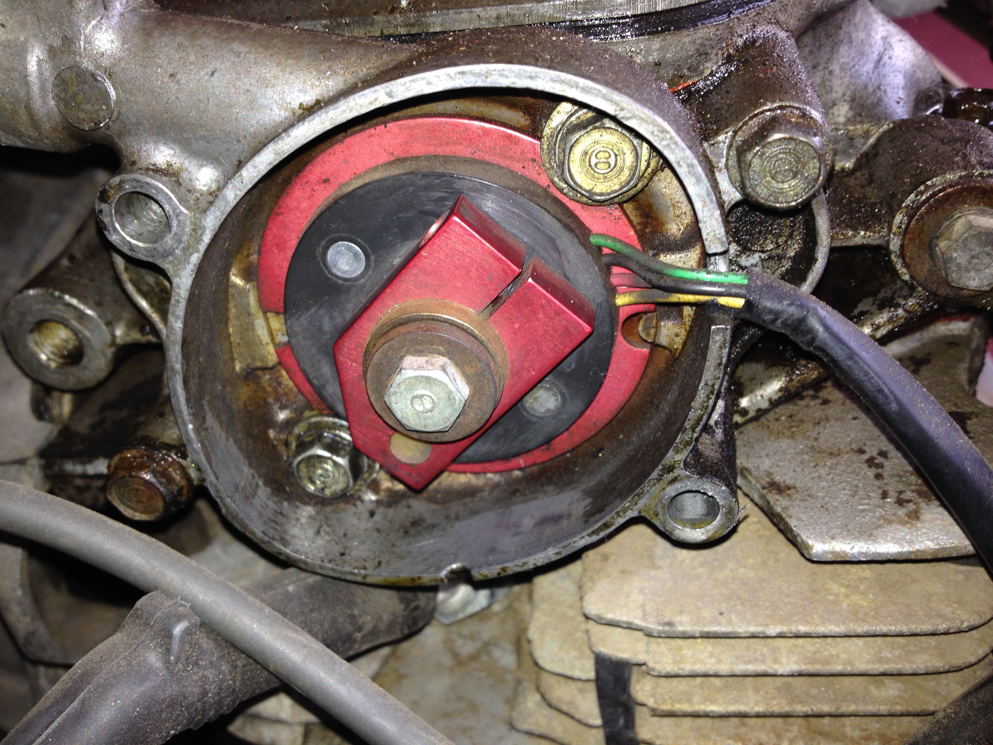

But here is the kicker, the points fire on both pistons at the same time, at
about 7.5K rpm you exceed point capability, your engine will stall (stop
firing) and pick up where it left off at around 6.5K rpm. But lets say you
modify your point system with an electronic system, you're still facing red
line of 6K and a final gear ratio that will keep you at 75 MPH unless you
exceed 6K RPM. Red Lines are there for a purpose, break the rule and you
may pay with a spent engine.

I was using the Tach on my Coupe to note when the points let go, so your 8K
RPM may be closer to the correct point. Although it might have been my
points too. Since the engine valves can impact the piston when out of time

Post by dean m »
here is one installed in my n600 the electrical box part is bolted to the fender well works awesome I think this is a kit for a 70's gold wing
On Thu, 11/13/14, nate smith
nateshalfpriceauto@...
Subject: [2cylinderhondas] (unknown)
To: "
Date: Thursday, November 13, 2014, 9:51 AM
Im unfamiliar with the motorcycle style ignition
system and how to instal coil. Also are there alternative
coils i could use
Sent
from Yahoo Mail on Android
