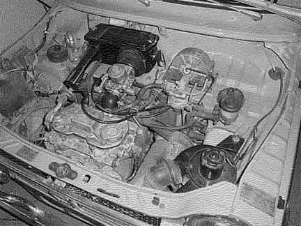

Here is a pic of a 72 booster, not mine but form my collection of photos.
72 booster pic
