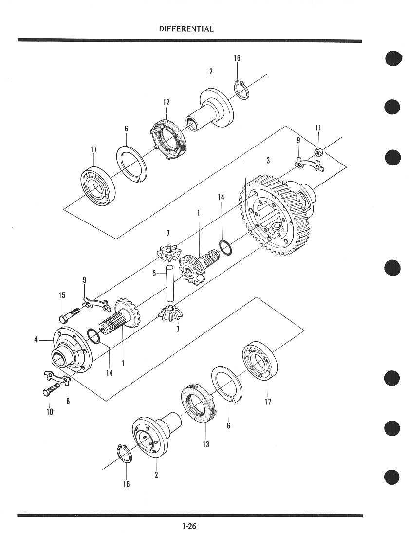

Hi Eric;
I think Tim did a great job and wouldn't have put the set ring up side
down. There is another O ring in the differential flange #14 in the earlier
attached picture. Some times these will unseat and I have had them leaking
before too. But these are parts that should be changed out during a
rebuild. You didn't mention which side the leak is on.
