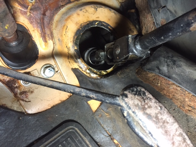

Hello all, trying to get reverse on my Z600 and suspect split pin for gear selector shaft is wrong. Can someone post me a pic or direct me to the split pin/bolt I need to use.
Shaft is not going far enough into trans to engage reverse gear. I am including a pic of what's there.

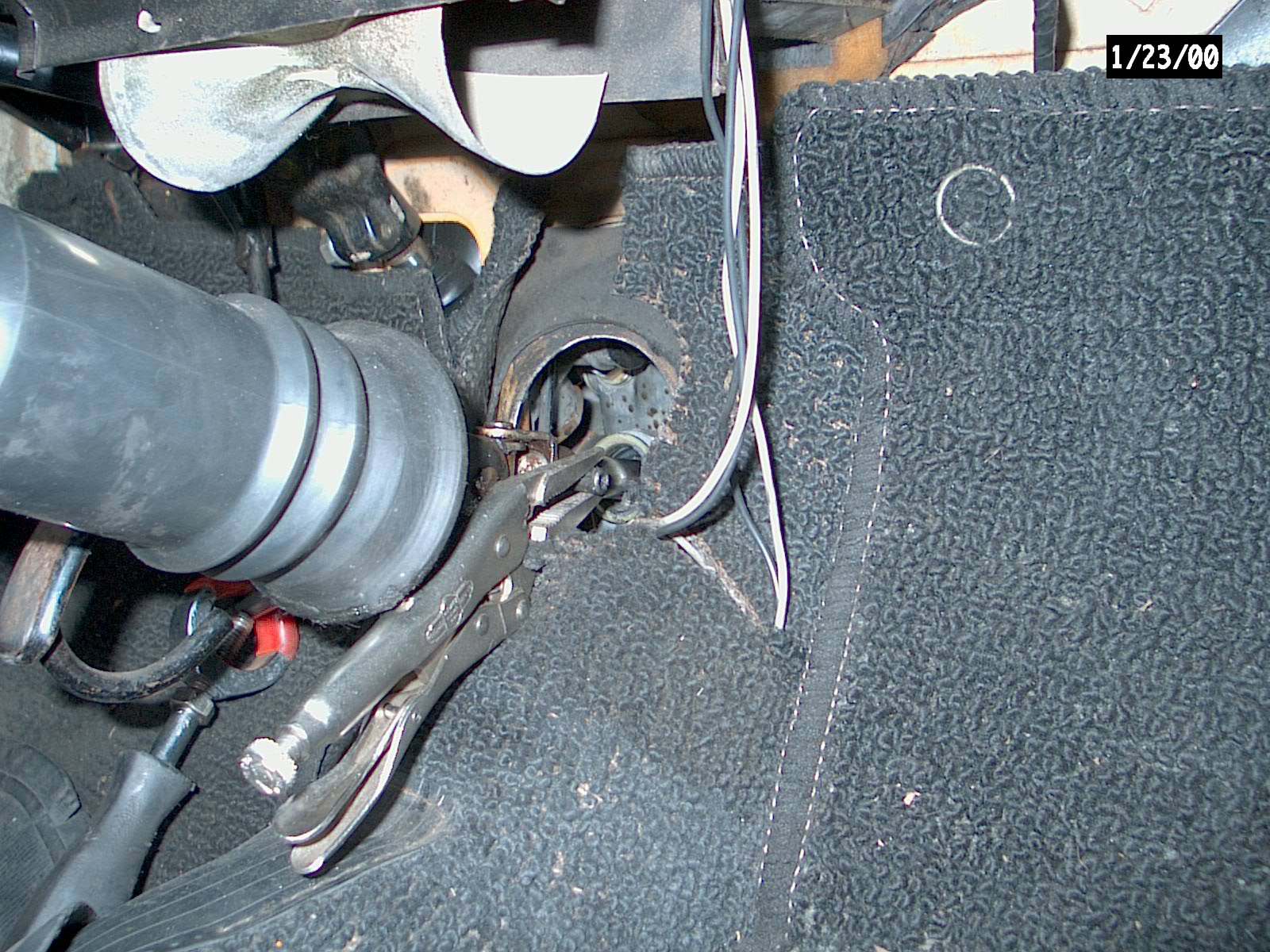

Kevin;
If you don't have a split pin go to the local Napa store and pick one up.
The size is 8MM Dia. by 19MM long.   Using a needle nosed vicegrip really helps, once in place squeeze it in with a channel lock pliers.

Your photo shows a bolt and nut. These will hang up on the hole and prevent engagement of reverse. Replace the bolt with a split pin.
Bruce.

Rear motor/trans mount is collapsed.

A �real quick short term solution is to force a piece of hard rubber under the steel piece that comes off the trans and is supposed to be vulcanized to the outer part of the mount. I actually used a piece of 3/4" pine to prove that was the issue. I drove the car for a few mouths before I found a fix. Good rear mounts are impossible to find. Here is my solution http://japanesenostalgiccar.com/forum/f ... 600s/page4

Yes, but there is still enough room to shift, the missing split pin is why it's not getting into reverse.
