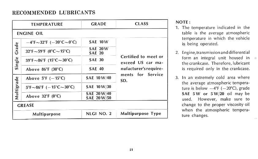

Hello everyone,
What are your suggestions for motor oil for my Honda 600 Coupe's engine which has 149000 miles and the typical weeping problem.

Re: Oil suggestions?
With the mileage on your engine and the temperature being above freezing use a good quality 20W-50 oil all year.
I am going with Pennzoil 20W 50 SN.
I was a little worried about using a synthetic oil, fearing its lower viscosity may leak a little more than the thicker oil.
My engine doesn't seep enough oil to warrant an entire engine teardown, so I'll just keep wiping down the block after every trip.
I agree with Bruce on the 20/50 and have always used Castrol or Valvolene with some Slick 50 .
I am in Santa Cruz area where temps rarely below 50F in the daytime.
I am also in a warm weather climate, Tempe, AZ, where the temp rarely dips below 40 degrees.
I ordered some Pennzoil 20W-50.
I was thinking about a straight 50 weight oil to slow down the seeping, but the only type I could find was racing oil.
