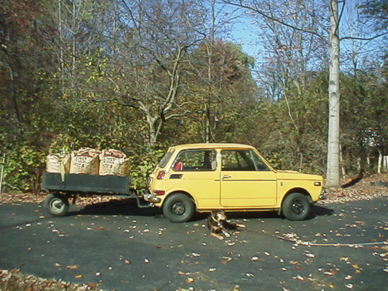

My N600 towing our 'wacky-wheel' trailer.� �We just scoot around town, never on highways, and never much more than 3 or 400 pounds back there counting the trailer !� �This old 1950-something Sears trailer connects to the car at two hinge points on the bumper, and the trailer wheel is on a 360 degree swivel.� �Probably not comparable to what you want to do, but proof the little car can pull !

On Wed, Mar 28, 2018 at 5:34 PM, Chuck Dean
