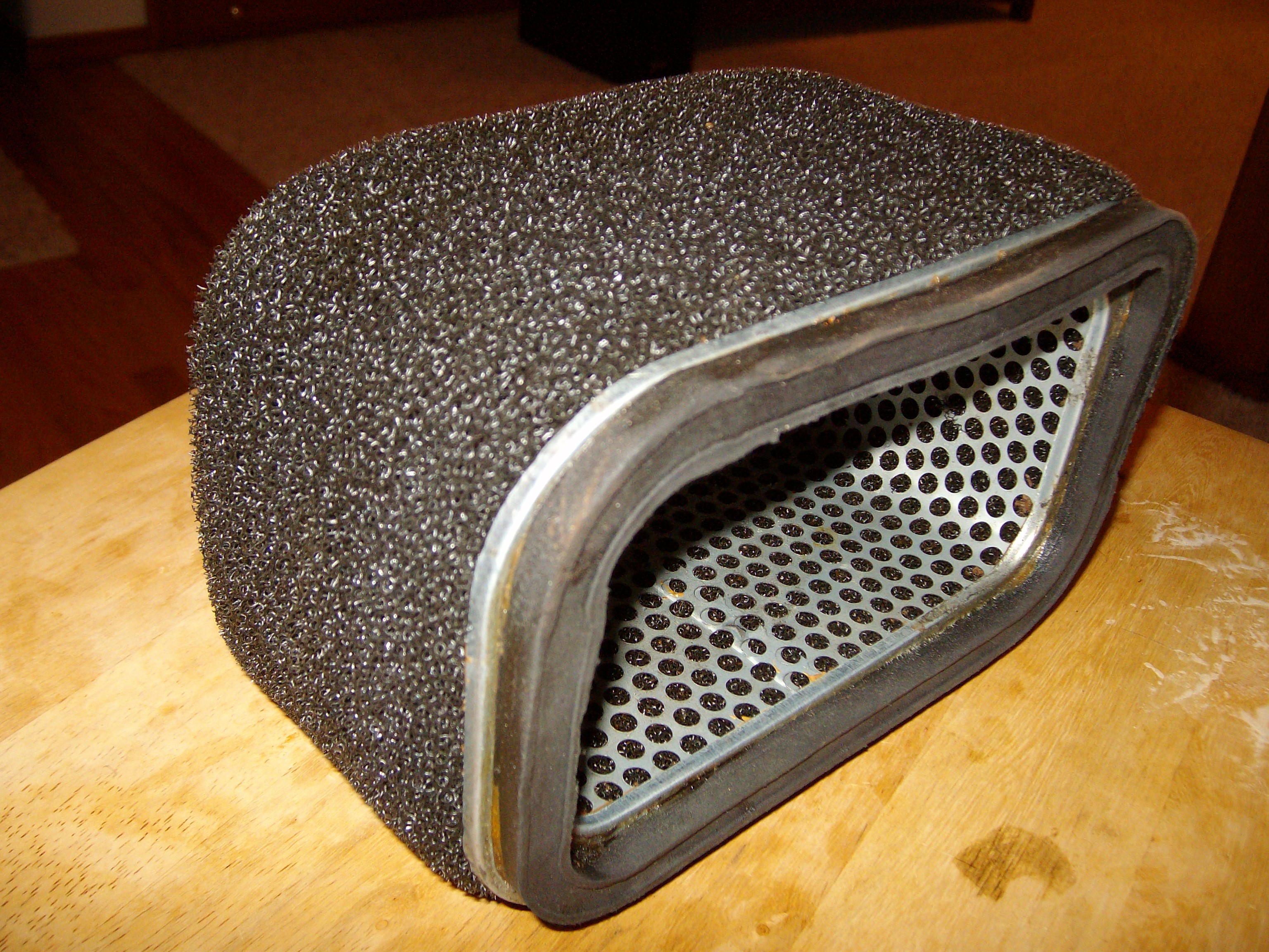

the shocks will be available at the end of the month there will be 100 of them I have the proto type air filter done. email me a i can send a photo and more info Kevin

Kevin Keough
- Posts: 37
- Joined: Sat Jun 27, 2009 1:57 pm
Re: new shocks and air filters
heres a photo of the air filter and shock the filter is washable Kevin
--- In 2cylinderhondas@yahoogroups.com, "Kevin" wrote:
Dave Kohn
Long Island,NY
I'm in for at least one set of shocks maybe two because my friend may also take a set. Are the air filter the washable type by any chance? You can email me a pic at nydyna88@.... Thanx> the shocks will be available at the end of the month there will be 100 of them I have the proto type air filter done. email me a i can send a photo and more info Kevin

Re: new shocks and air filters [2 Attachments]
Hi,
I'm jumping into this late. Are you rebuilding old shocks or modifying new ones to fit the Honda 600?

feltonminicycle
- Posts: 352
- Joined: Mon Apr 14, 2003 2:50 pm
Why don't you post a photo in the Albums section and place the direct link to the picture?
