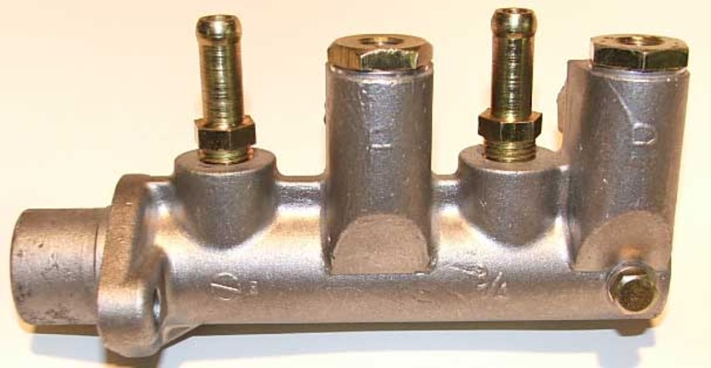

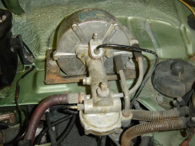

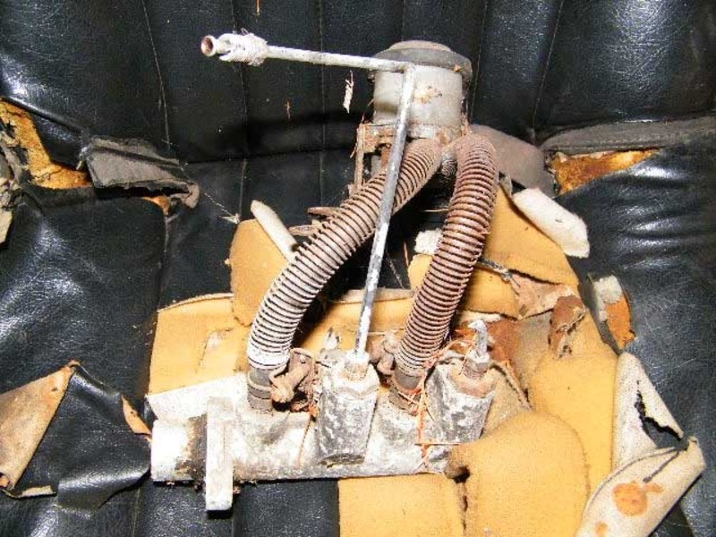

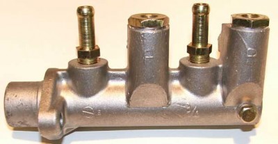

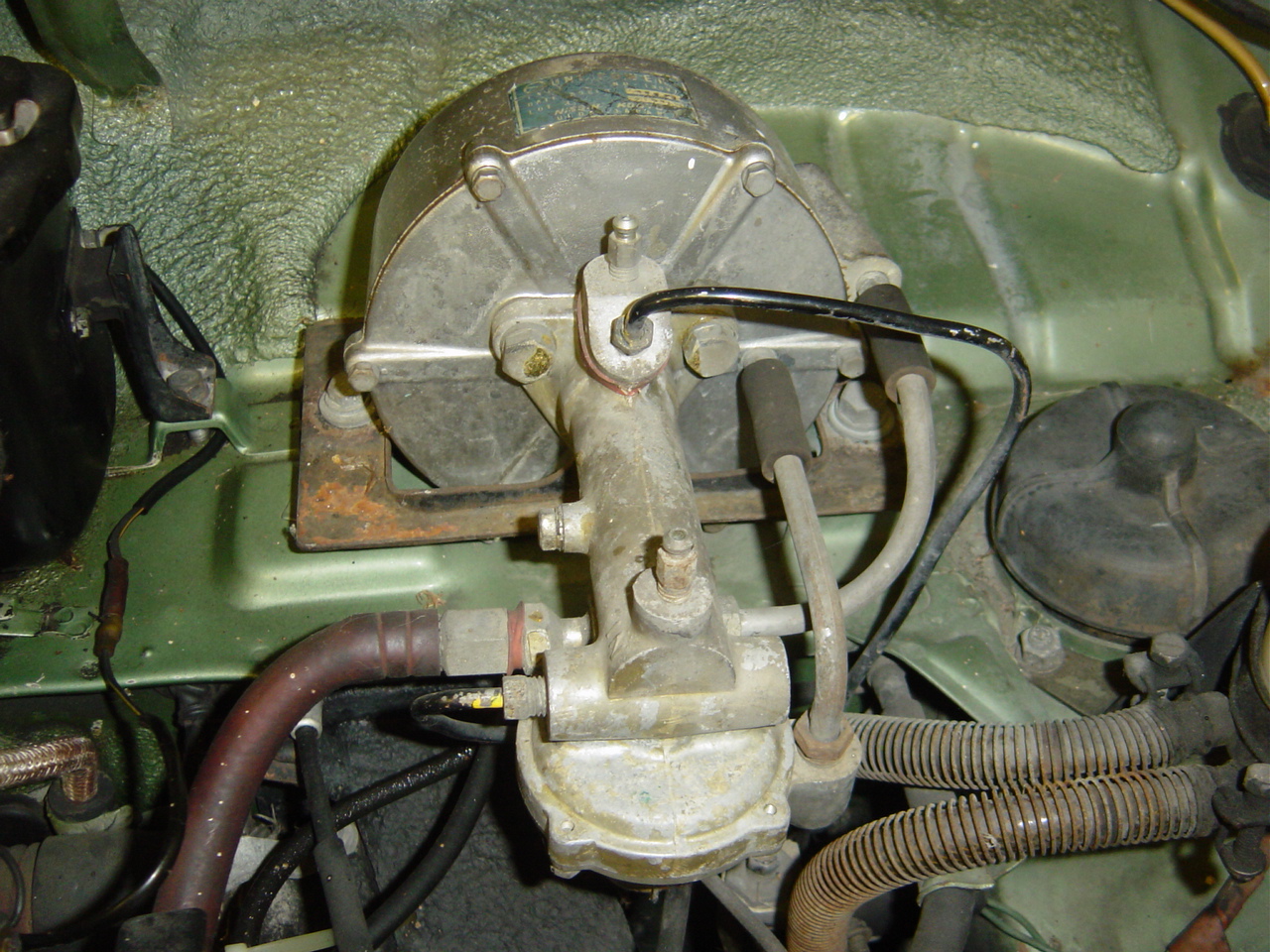

I am rebuilding the brake system on my N600. The booster is completely bypassed. Does anyone have a diagram (or photo) of the tubing connections from/to the booster?
Thanks! Skip
Thanks! Skip
Re: Brake booster bypass
BTW I have the middle-type Booster, and 3/4" master cylinder...
Miles Chappell
- Posts: 297
The one line that someone likely bent and screwed into the F port on your master cylinder goes to the OUT port of the booster - that's the one closest to the canister. There is a short tube that goes from the F port on the master to the IN port on the booster - that's the one closest to the front of the car.

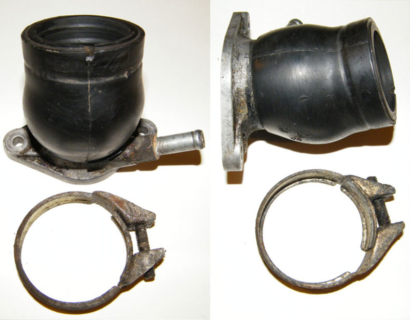

Miles, this is excellent; thanks so much. Now I have one more question which maybe you can answer with another snapshot: where does the booster vacuum hose (?) connect to the ?manifold??
Skip
Skip
Miles Chappell
- Posts: 297
Manifold has a fitting screwed into it at an angle facing the booster.

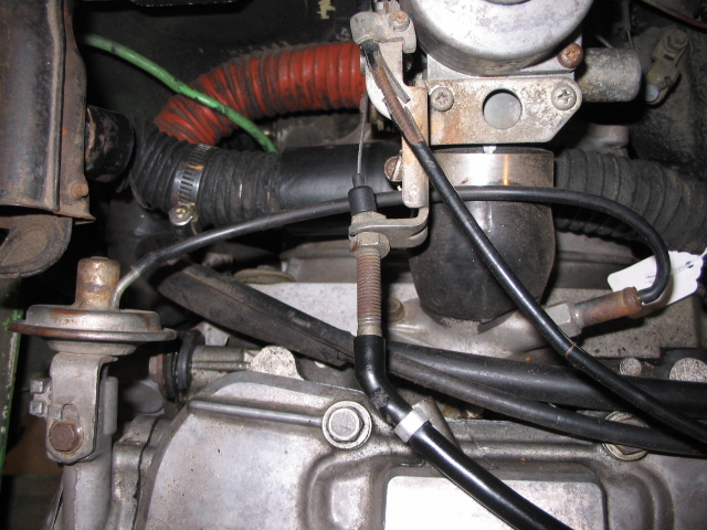

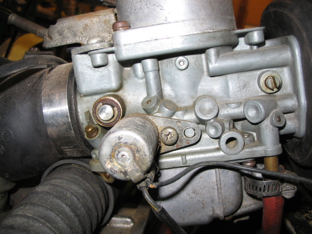

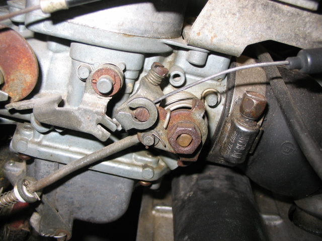

Thanks again for your reply - and for the excellent series of photos on rebuilding the booster.
One question leads to another: The vacuum connector for the booster on the manifold of my car is being used for the vacuum timing advance (see picture).
Now I wonder what the correct routing is for this vacuum timing advance tube: Can you help me? Here are photos of the left and right sides of the carburetor: hope you can show me the connection:
