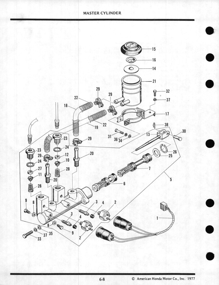

Re: The two small bolts at the front of the Master Cylinder
If you’re talking about #8 and #9 they hold #6 in place.

Both of the #9s keep the #6 piston from bottoming out in the cylinder. They are 6x1.0mm and about 10mm long. The threads are gone from the end of the bolts about 2mm back from the tip. They act as stoppers to keep some fluid in the end of the cylinder.

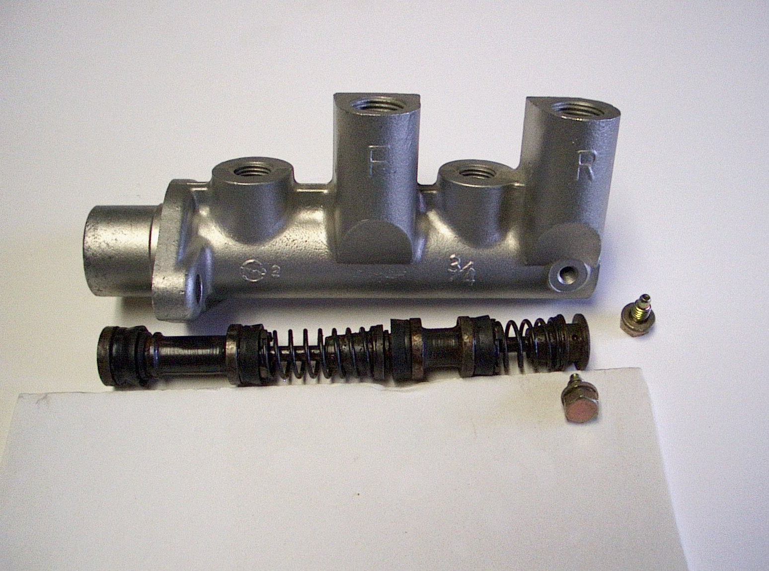

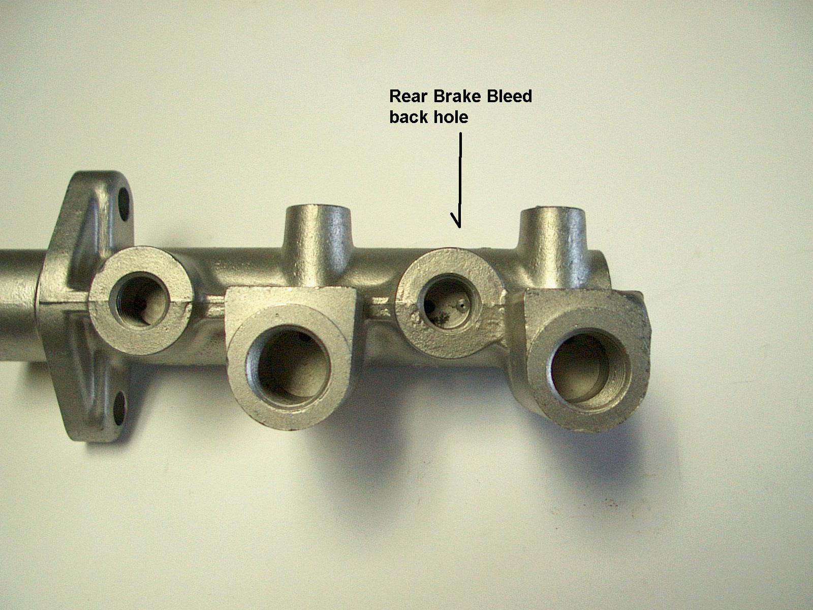

As I said, it holds the rear brake piston in place.  The ends of the bolts act as pins to keep the piston from moving (see attached picture showing where the bolts are placed at the end of the piston) and causing the bleed back not to work which allow the rear brakes to release.   If the piston cups come out of alignment with the bleed back hole  (see attached picture showing the bleed back hole) the rear brakes will not release when the brakes are applied.   It has nothing to do with keeping fluid in the end of the cylinder as fluid will be there anyway.
