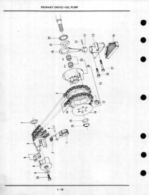

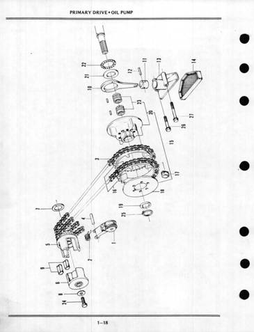

I think your speaking to the older Chevies,  see here from the Honda Sedan and Van shop manual, if you have 145 lb-ft of torque on your front
Bearings they are tight.  I normally set my impact wrench at 100 lb-ft and tighten them up.

If the car feels like it is trying to move, it is possible the problem is not the transmission itself. The first time My car refused to move even though it seemed to be shifting into each gear correctly, I discovered that there is a set of rubber shock absorber things that are on the clutch side of the engine that smooth out the transfer of power from the engine. They had just turned to mush.

Are you speaking of the dampers #9 or #11?

Bill yes  that's what I was talking about  that I will need  mine  are not tight
