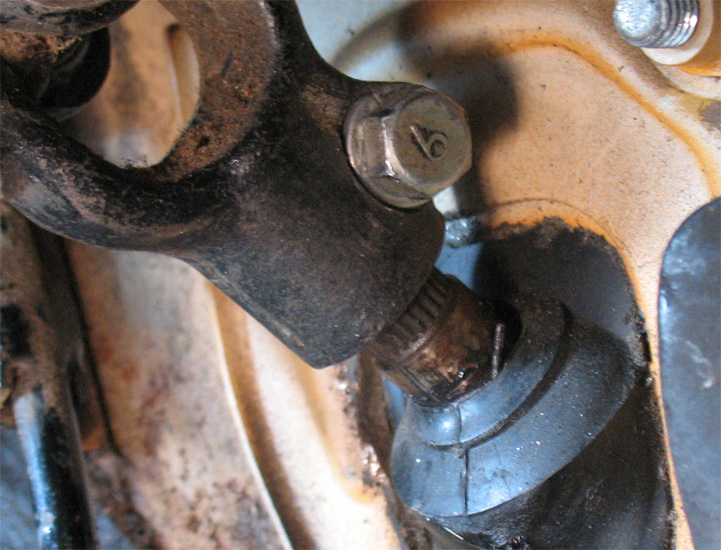

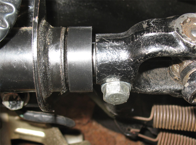

I checked the position of my steering joints.
The top is set up for the bolt to lock on the shaft, in-between the two splined areas.  On the bottom, the bolt only clamps the joint onto the spline.  So I am good there.  My issue right now is, I find that to be able to get the joint over the splined top end of the steering column far enough to have the bolt land in-between the two splined sections, I need to pull the bottom joint off the spline a bit!  The steering wheel seems to be seated all the way down, so I don't know where I can find any "slack".  I don't know if it is as it should be - though it don't look right.  Please see the pictures of the top and bottom joints, as things stand now.
good --- http://www.honda600coupe.com/steering_j ... _joint.jpg
not so good --- http://www.honda600coupe.com/steering_j ... _joint.jpg
I wonder if before all this happened, the top joint was set with the bolt passing ABOVE the top splined section, and just holding on by clamping force, or maybe nothing.

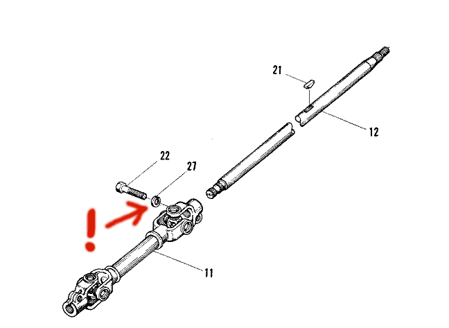

> > Did you know that it is possible for your steering shaft to become > detached > > from the articulated part below it, all on it's own? When > this occurs one > > is left with a free spinning
> > steering
> wheel. See the picture that shows the crucial part...
> http://www.honda600coupe.com/photos/cru ... g_part.gif
> > I've had my Coupe for 8 years and never needed to detach the steering > shaft.
> > But, some DPO did, and decided against replacing the lock > washer. OMG BIG > > MISTAKE.

> > I hereby recommend that before you drive your 600
> Coupe or Sedan again, take
> > a peek under the dash and confirm that this
> bolt is tight, and the lock
> > washer is in place. The bolt doesn't have
> to be "loose", just not tight
> > enough.

Hi Steve, looked at my steering assembly today. If the top joint is in the right spot with the bolt through the notch in the shaft that's good.
Not sure why the shaft is not going all the way into the spline on the bottom.
Maybe loosen the steering shaft mounting bolts and move the whole assembly towards the front. The steering shaft can't come out of the bottom joint unless the rubber bushing above the top joint is bad.
If you loosen the bottom joint, you should not be able to pull the steering wheel out!
Lyle
